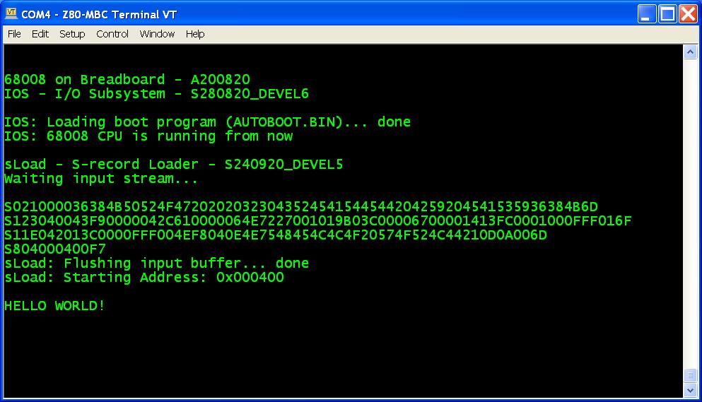

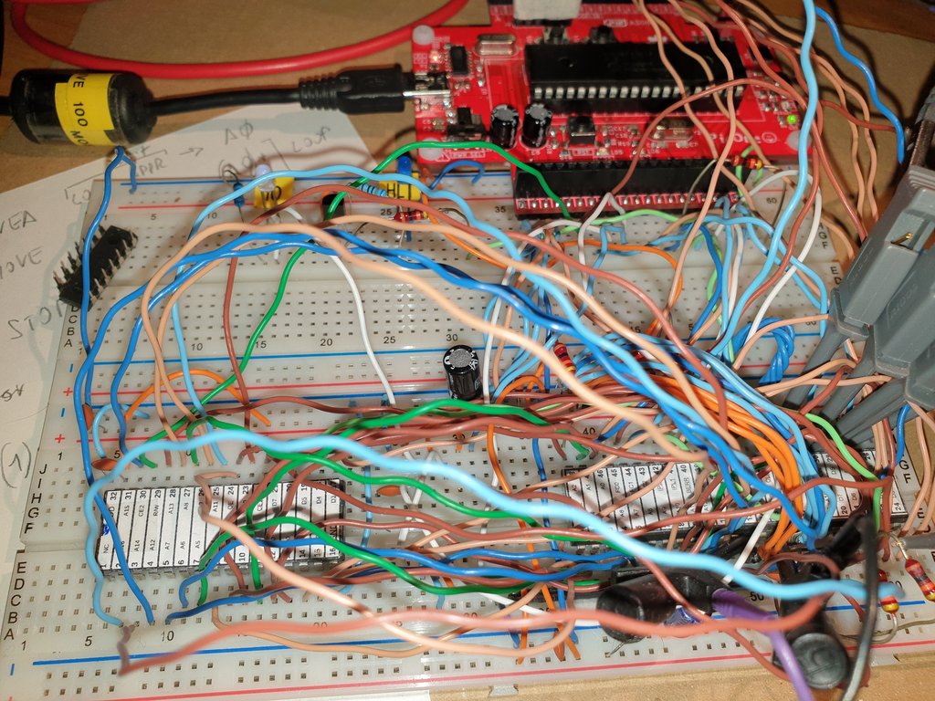

Hi,
this is my last toy, a 68008 running at 8MHz on a breadboard with 3 ICs (68008 CPU, 128KB SRAM, PIC18F47Q10 MCU).
The PIC MCU (on the custom red PCB) emulates the ROM/EPROM, the clock generator, and all the I/O ICs (including the interrupt controller) on the CPU bus.
In this video an example of an automated cross-assembler toolchain using sLoad (a custom s-record loader) and Easy68K as assembler.

Very nice! I think it's a particular category, and an interesting category, of modern retro rebuilds where the glue (and maybe more) is implemented in a microcontroller.
